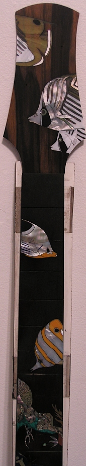

Finally something new to post!
I can't let Paul have ALL the fun...

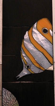

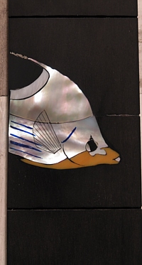

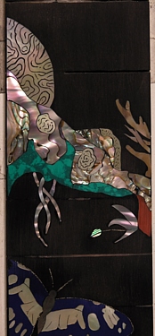

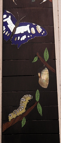

This is the entire scene that goes with the Auriga butterfly headstock I posted a while back. This one took a while- Lots of various stones, etc.. all inset in reverse to make sure they are thick enough to withstand cracking. Plus pearls, silver, woods, corian, and a lot of engraving.
It's basically a fantasy of butterfly fish meeting butterfly insects. The upper reef area turns into a hidden hanging garden. Thanks for looking!

Beautiful work. Both types of butterflys are very life-like, and stunning. I really like the brain coral too!

I wish I could remember how long this one took. I am sorry to say I was working on it in spare time and dedicated time between other things so I didn't really count hours. It took at least 40-60 for everything, art and research included.
What I mean by inlaying in reverse is I used the recon stone at about double to triple the thickness of the shells, glue it face down, then routed to the thickest depth, back filled with glue, and inset them that way.
Any time I use a big piece of recon stone I get worried now about it cracking after it's in. Not that it happens that often, but I did have it happen once with green gaspeit and it was really frustrating. I inset the yellow corian deep as well, because as it gets thinner against ebony it starts to loose it's color.
I have some regular general pattern type stuff up next, if anything different or cool comes along I'll post it.
Thanks.
